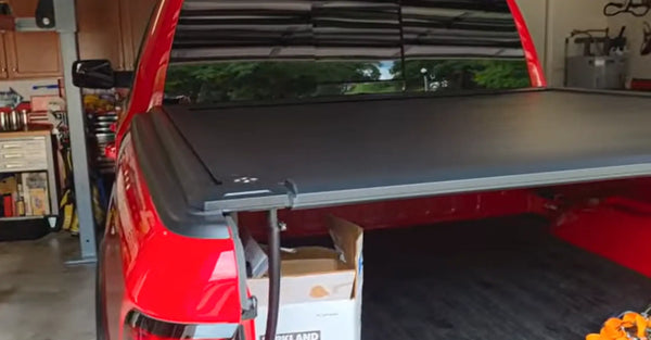

INSTALL TONNEAU COVER
    Grab a buddy and carefully lift the entire tonneau cover assembly onto the truck bed. Do not slide it along the bed rails, or you'll tear up those foam seals you just applied!
    Set it down leaving about a 1-foot gap from the front bulkhead.
    Plug the main power harness into the ECU connector.
    Carefully lift and nudge the cover as far forward as possible. Make sure to leave a slight gap between the canister and the front of the bed so they aren't rubbing.
