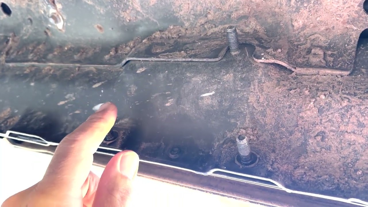

  • ● Locate the mounting studs on the rocker panel (under the doors).
  • ● Place a Plastic Insulator (F) over each stud first. This prevents corrosion and noise.
  • ● Mount the Front Bracket Assembly (A) and Rear Bracket Assembly (B) onto the studs.
  • ● Note: Do not fully tighten these nuts yet; leave them snug but adjustable for alignment.

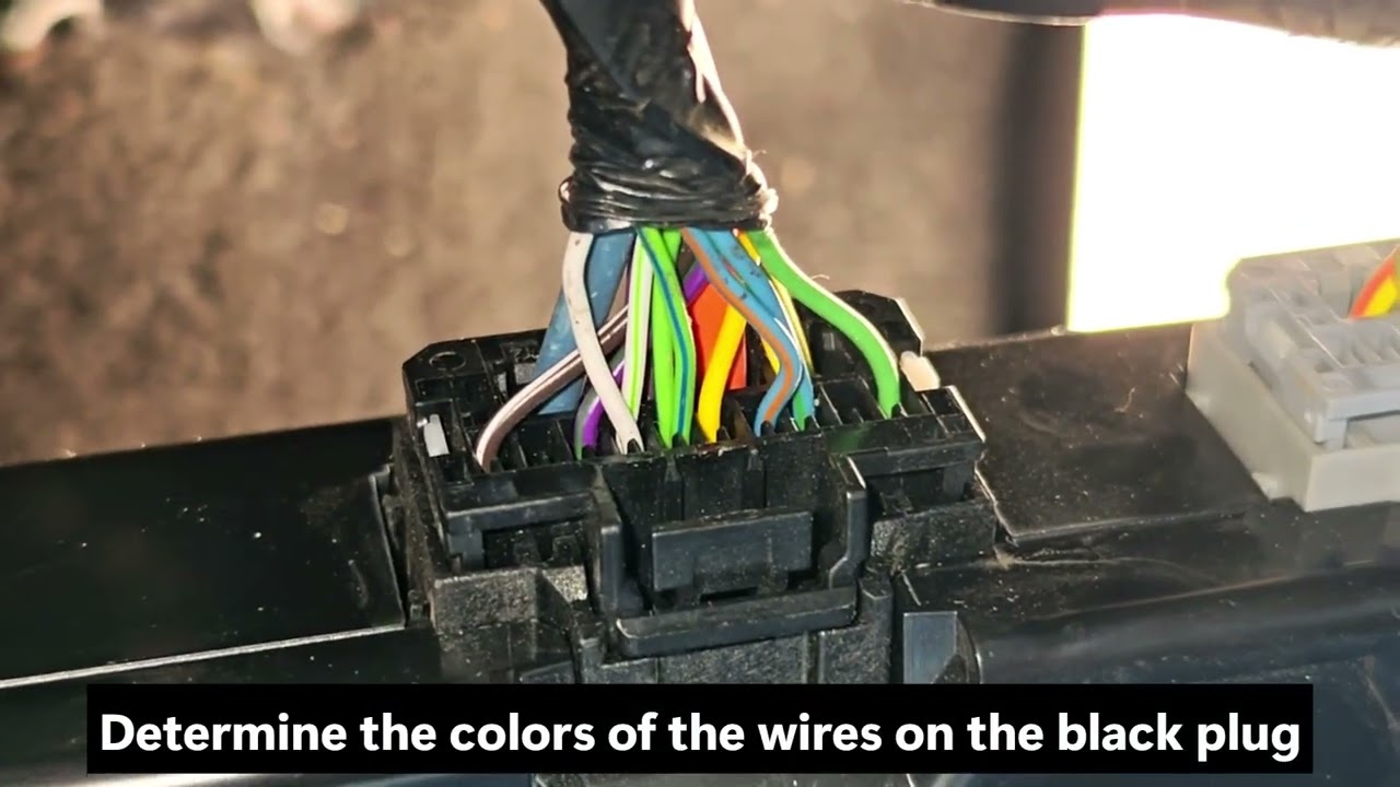

Locate & Identify
  • ● Locate TBCM: It is the black module under the steering wheel, directly behind the OBD-II port.
  • ● Access: Press the center locking tab and slide the module outwards to reveal the black plug.
  • ● Identify Wires: Look for the twisted pair on the Black Plug.You need to find two specific twisted wires:
    CAN High: Green wire with a Blue Stripe.
    CAN Low: White wire with a Green Stripe.
  • ● Note: Wire colors may vary slightly on newer models. Rely on the pin position if colors act differently.
