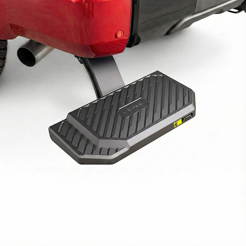

It provides a stable 5-inch drop, turning a high-impact jump into a natural step. This significantly reduces strain on your joints and spine during loading.
No drilling required—it’s a 100% bolt-on design. Most owners can have it installed in about 30 minutes using just basic hand tools.
Built from high-strength die-cast aluminum, this step supports up to 330 lbs, giving you a rock-solid, wobble-free platform every time.
It’s completely hands-free. A simple nudge with your foot deploys the step instantly, and you can just kick it back up when you're done.
