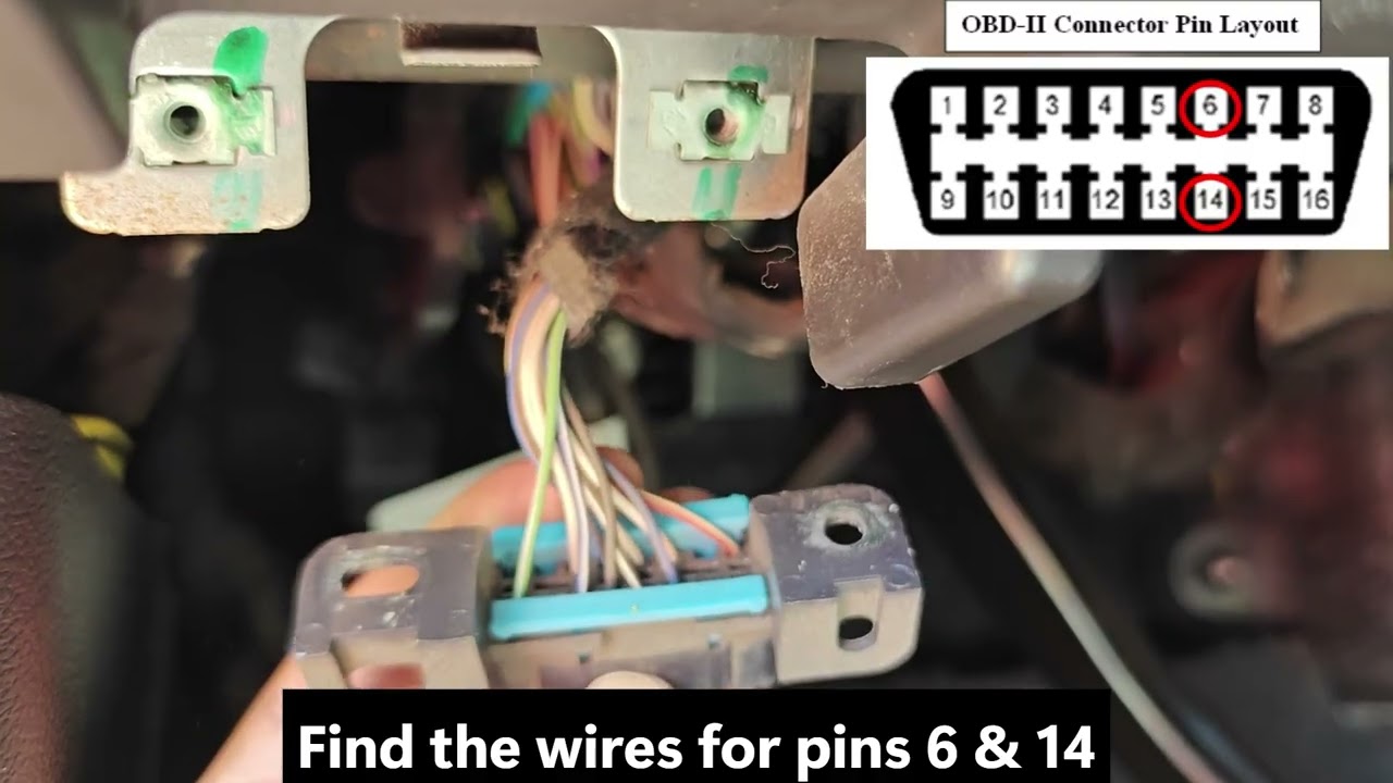

A1
Locate OBD-II Port
Locate OBD-II Port
  • ● Locate: Find the OBD-II Port under the steering wheel, near the front hood release lever.
  • ● Access: Unbolt the two bolts using a socket for easier access to the rear side of the plug where the wires are located.
A2
OBD-II Connection Guide
Part A Wiring
Signal Factory Wire Main Harness
CAN LOW 3rd from right (lower) Yellow
CAN HIGH 3rd from right (upper) White
Note: On some vehicles, wire colors may differ. Rely on the pin position. After connecting, return the module back into its place and tighten the bolts.
